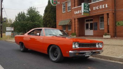

not sure about the front combo, but ive got 275 60's on 15x8's with 4.5'' backspace (wheel vintiques stock item) on the back, only get some rubbing when the bird is full, and because my bird is lowResized_20180318_140508.jpeg

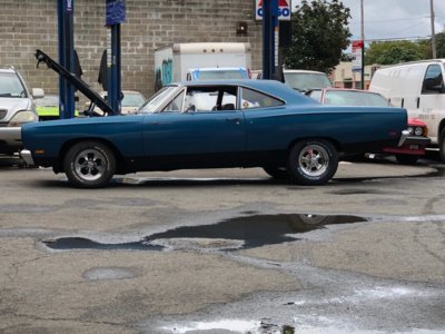

Ive got 15x8 w/4.5"on the front with 235 60 with no rubbing, so you should have no problem
7,704
Now that look's like a Runner. With that old school look I am use to seeing for the 60's and 70's. Not this lowered to the payment and looking like a Cholo. and scraping the bottom off the car on every bump. It is missing the traction bars usually paint them yellow. All in all it is a winner in my book. How much rubber did you get on the back 8 inch or 10. :thumbsup::thumbsup:
Anthony69Runner
Mar 4, 2018
64
20
Franklin, New York
15 X 8
