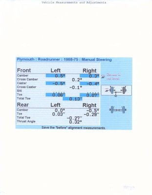

a correct or better alignment makes all the difference..............along with a good set of shock absorbers.... I hate to say it but my '69 GTX does the exact same thing as you describe. I've been holding off on doing an alignment to the GTX until I change/replace the upper and lower control bushings/ball joints so I just did the "string" and tape measure alignment. I had the '68 road runner done by two older service guys from back in the day at a local Dodge dealer and one in Albuquerque, NM (Zangara Dodge) when I drove it back to Ohio in 2003. On that trip from NM it was exactly as you described and I thought is was very windy and that was causing the left and right "darting" the rr was doing over road breaks and over passes/bridges. The best alignment I've had on the road runner that stopped all of that was at the local Dodge dealer and I had the guy print out the specs if I ever need to align the car or another again. If you want I can probably find the print out and post it?

Don't think you need an old guy to do the alignment, I just mentioned that because that's what happened by coincidence. I don't even know if the last alignment on the '68 road runner was even correct to what is in the Chrysler shop repair manual but I asked for a print out of what it was set to in case I still had the problem and low and behold it was great!! Drove straight and no darting and you could take your hands off of the steering wheel at any speed even over bridge and overpass breaks in the road. Even if it isn't correct I'm getting the GTX set to these EXACT same specs. I posted this on another Mopar site and out came the comments that it wasn't correct or "that not how I set them up" and yada, yada, yada by the so called experts. All I know is it worked perfectly AWESOME for my '68 road runner with 225/60-15's on 15x7 BFG's and that's what I setting the '69 GTX to.
'68 road runner is a manual steering car
