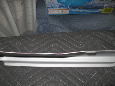

Any one have pic's of it off the car. Mine has some bend's that don't look like they belong. The only thing I see is pic's of new ones but not good enough to see if what I have is rite. I don't think so but pic's would help. Russ.
7,704

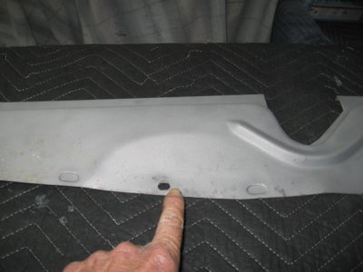

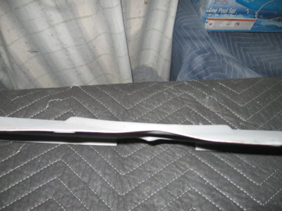

Ok I will get some pic's and post it here. Here they are curved Left. Curve in middle. then a curve at the right. Don't believe they belong thinking that it should be straight all the way across. Thanks for the help. Got the body hammer out still. :BangHead:IMG_0101.JPG IMG_0102.JPG IMG_0103.JPG

Yes I Agree with you. Like we both know things like this get bent. Either when working on it or if a fan belt brake's. Who knows. So will take a body hammer and straighten it tomorrow and paint the darn thing. Thanks one less thing to work on.
2,352
Russ those waves should come out. It gets painted black, I use flat just like the blackout treatment on the radiator support

The part has some obvious stampings in it that stay but this piece bolts to the bumper has nothing to do with the hood. The bumper got dinged bending the rock shield is all
7,704
Yes I only took out what was not original to the piece. It is not that stout of a piece of metal and could be bent easy enough. Just did not want to take out something that was put into the metal on purpose. Thanks again. Russ. :thumbsup2:
