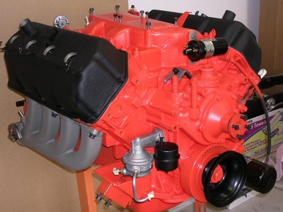

He probably has the electric pump pushing fuel to the first filter which wouldn't be so bad. A filter ahead of the pump is a restriction and the pump has the ability to push fuel threw a filter especially a dirty one beyond it rather than to have a starved pump. Think about how far it pulls fuel from the tank with out an electric pusher at the tank. On my jeeps I split the return right before the carb. Here is a setup for a Hemi or 440-6 bbl. Steel line goes to rubber to the pump, rubber to the vapor separator or filter then to the carbs, you can see the two nipples at the bottom of the separator.
Great, thanks. I was thinking the same thing. A filter ahead of the pump must be a restriction. The Eddy pump I have produces 6 PSI, so I agree if it has to pull all the way from the tank then through a filter before it starts pushing, must have been restrictive.
I asked him to do exactly as you have shown. I'm sure that will work. Thanks so much.
