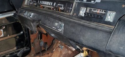

Attempted to remove the switch panel below the dash instruments on my '69 to repaint/recondition it. From what I read, the switches (lights, wipers, etc) come out with the panel and the wiring could then be disconnected from the back of the switches. Is that correct? Also, after I removed the four screws on the switch panel and tried to pull the panel out, it was stuck so I didn't try to force it. Is there something else that's holding the panel in place?

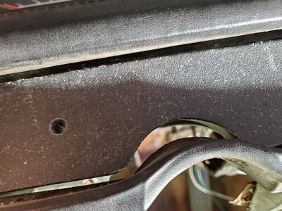

Remove the pad with the panel if you can to prevent damage to pad. Yes, there are a lot of speednuts on the pad. If you don't want to , then I also recommend removing the dimmer switch as it is really a tight fit.
Every slotted/larger hole you see below is a bolt holding the pad. (Ignore the bottom right one).

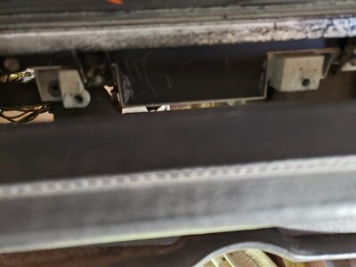

I may have misunderstood.
But I thought everyone was telling me the pad could be removed along with the switch center section as an assembly.
That is not the case as I found out this weekend.
There are 3 screws holding the upper pad to the instrument cluster that are behind the top of switch center section. Via metal tabs..
In other words unless you can move the switch panel enough to get those screws, the pad will NOT come out along with the switch center section.
I moved the instrument center section enough to get the screws, but normally this does not seem to be possible.
Or at least easy.

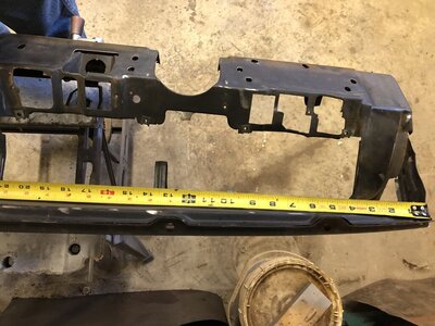

Switch panel first. It will come out but be very careful. I use a heat gun to warm the pad in the corners to reduce the chances for damage.
