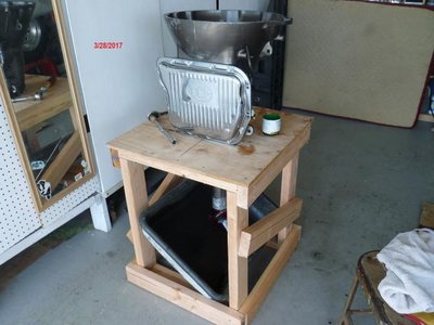

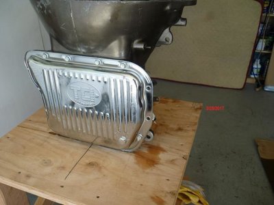

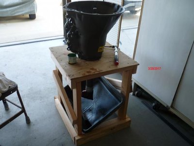

Thanks to all for the great advise. I made a table to suspend the transmission. The H/F slide hammer worked great after some adaptations to it. The flat seal puller I had worked great in removing the seal. Hammering the new one in was a challenge but got done OK. As usual, nothing goes 100% with any of my projects. I lost one of the pump housing bolts so I went to the local Dodge dealer and purchased a couple of new ones.
Once I get the headers back from having them heat treated with 'silver ceramic' coating, I can start putting everything back together. The Hooker long headers will ONLY go in without the transmission mounted and even then it is a very difficult fit.
Attached are some pictures of the work.
