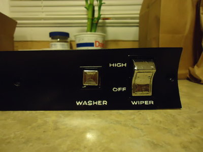

sanded and repainted the lower switch bezel, had a nasty scratch from left to right, got it looking better. this weekend when i get home from work I will start tossing up some pics for enjoyment :basketcase:

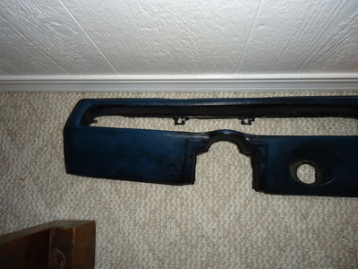

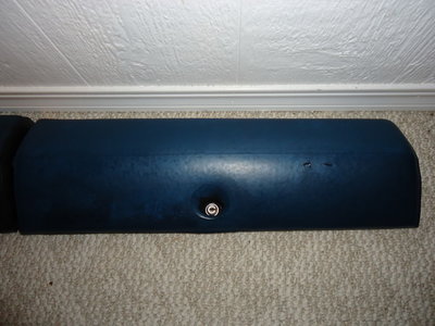

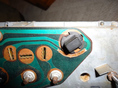

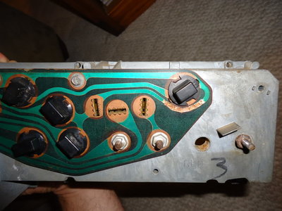

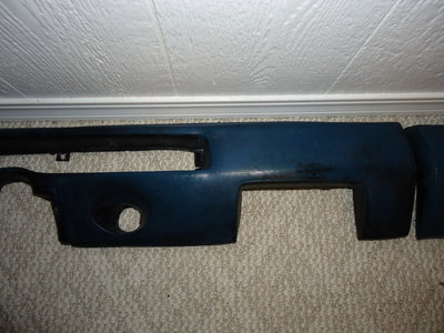

pics!! dash restore pics i took just now!
just picture my original dash pad color as spraypainted black, and the lower metal bezel was scratched and paint was coming off. enjoy :drool: and that circuit board is a repair using conductive adhesive copper tape, the existing trace was fried, so i cut out the old copper and replaced it. hope it works. Ive got some touchup work to do on the bezel.
