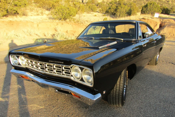

Non original everything in that car but its still a cool looking cruiser. Weird fender tag...i am familiar with the '68 as i own one but there is no trans code on that tag?? The vin tag also has one non factory rivet too.

The Fender Tag thing was mentioned in the comments section by someone. I don't know enough to comment.

so no door jam switch . driver door plug missing . that cable ran under the trans pan is great and that shifter most likely doesn't have a lock out.

I can see the obvious, like the interior and some other little minor things. But you guys take it to another level and really see what is missing or just wrong. Good stuff

to be more picky look at the bottom of the rear quarter panel to quarter panel extensions it has been replaced [ no spot welds ] if done right its all good if not well ......

1969 Lynch Road FT. The trans code is there however. "D32".
