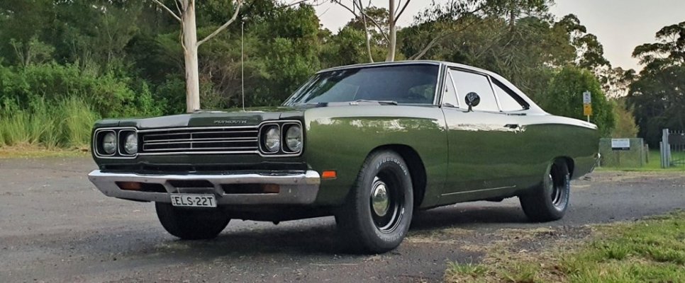

Not very good pics, all I have at the moment as I just got it.

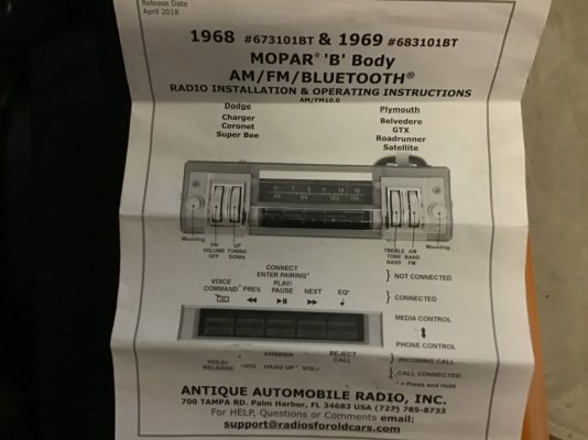

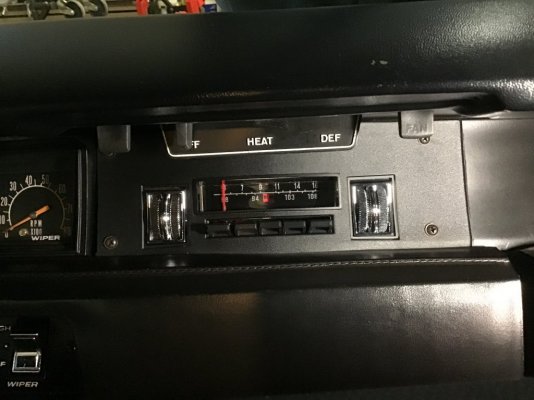

I put this one in my roadrunner a couple years ago. It took forever to get it. As I recall 3 or 4 months. Once received and installed it works very well. Overall I’ve been pleased with it.

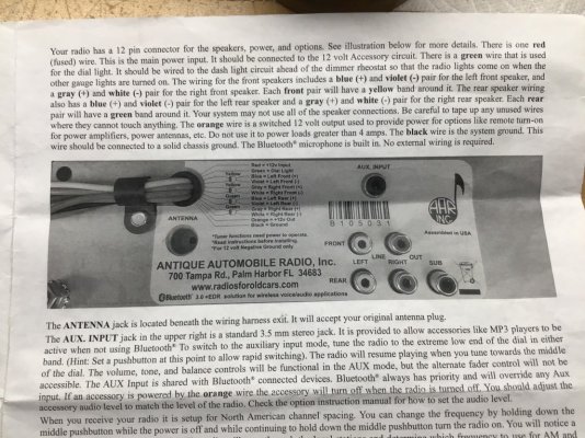

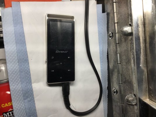

Here is a picture of the back of the stereo, I either Bluetooth music, use regular radio, or use an IPod. The connection for the iPod is through the aux port. Hope this helps.

Oh and I have a standard 69 roadrunner trim plate.
