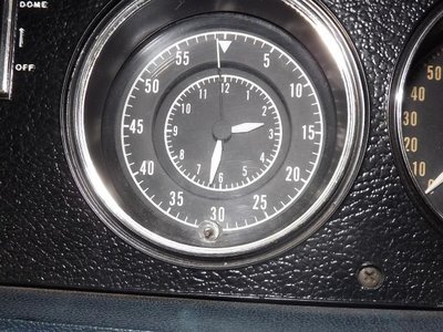

This is the tach/clock combo that is not working. I've seen different variations of what was offered as an option back in the day. How many of you have this style? Would like to get both functioning once again.

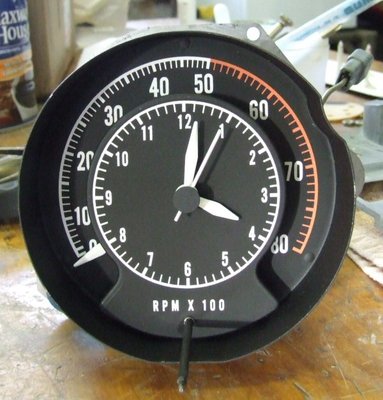

That isn't a tach/clock, it's just a clock which was one of the options.
If it had the tach, it would look like this:

Yea, that's just a clock.
