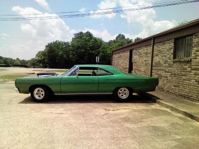

New RR owner here. Pretty new to MOPARs. My newly acquired '69 has very old tires that I want to replace. Goodyear Eagle GTII's... 235/60R-15 in front (26.1" tall) & 255/60R-15 rear (27.0" tall).
I like the look & the stance, but I'm considering putting 275/60R-15 on the rear to add an extra 1" (28"tall). Is anyone running that setup? Any photos?
My only concern would be whether that might give me too much height in the rear &/or make the fronts look small (or otherwise end up with an odd look).
Comments/opinions??

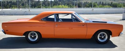

Im running the 275 60/s in the rear with the 235's up front and they look rad

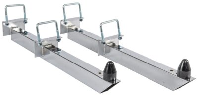

Yes if I was going to drag race my car would have traction bars on it. Those in the picture are way to fancy we use to make our own. Cool picture of them. Brings back memory's of our racing day's. :thumbsup::thumbsup::thumbsup:
13,675
828
Generally speaking traction bars are not needed on a MoPar because the axle is not positioned in the center of the spring like on a Ford or GM product. It is forward of this point. This shorter front spring segment makes it stiffer and it therefore functions like its own traction bar. If traction is a problem then additional clamping on the front segment of the spring and/or the addition of an adjustable pinion snubber is usually all that is required to rectify any traction issues. The Chrysler Engineers knew what they were doing. Leave the slapper bars to the brand X cars...

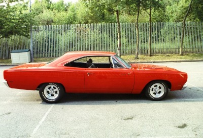

Rick Rocket,here's a pic of mine with 275/60 15 and 235/60 15.
That's not your car. You just grabbed that pic off of the internet. Everyone knows that your car has the factory shiny hood stripes...

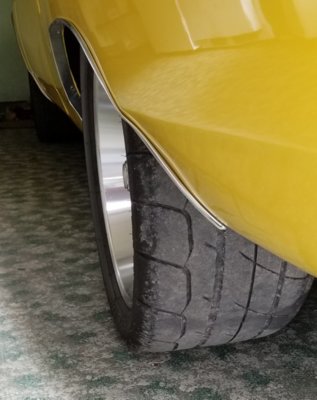

That looks great! I'm looking for that extra height in the rear. Looks like you've raised the suspension some as well? You've got more clearance from the top of your rear rims to the fender lip than what I have (see my pic on first post here). Are you running different springs or air shocks?

That looks great! Thanks for the photo.
I’d like to get just another inch or so between my rear rims & the fender lip.
I guess I would need longer spring shackles or recurved springs.

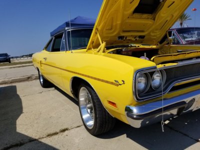

I bought the staggered set of Year One aluminum Rallye wheels, 8" front, 9" rear.
The only tires the rear 9s have worn are 315/35/17 Toyo Proxes TQ drag radials. My suspension is totally stock.
The tires never rub, perfectly centered, are almost 11" wide treadwidth, fine in the rain, great for traction....
And look KILLER!
