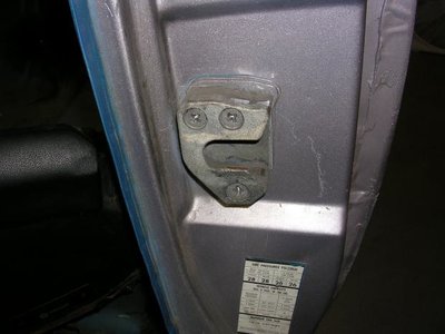

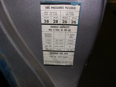

Here is mine, drivers door jam. Keep in mind it came with 15" tires so the info is different

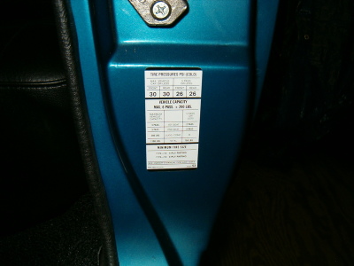

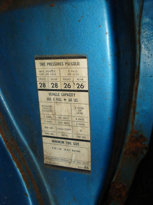

Here are two original '69 Road Runner tire pressure decals.
The blue is from a 383 A/C car and it is NOT 30 psi front,! Maybe that's for a 440 engine with A/C but not sure if a 440 is that much heavier than a 383 with A/C??
This is off of my '69 Road Runner non-A/C and I would think it to be correct for a 383 Road Runner WITHOUT A/C.........BUT and that's a BIG BUTT :tennis: because my car, although it still has E63/383 engine on the original fender tag is an A12 Lift-Off-Hood Road Runner :tennis:
IMO 28 psi - Front and 24 psi - Rear is the correct tire label for a non-A/C 383 '69 Road Runner with F-70 14 tires.

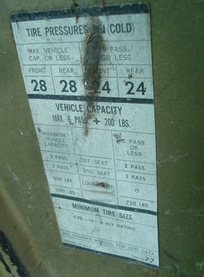

Anywhere in that area they were put on by people in a hurry not a machine. If you look at page one my first post the picture shows mine was lower and crooked.
