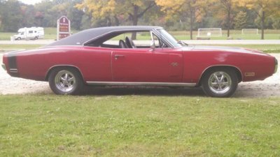

The following are the sizes I used. Achieved a good stance.
15x7 with 225/70R15 front
15x8with 275/60R15 rear
I'm running (or was until I disassembled the car) the exact same combo. 4" backspacing on the front, 4.25" on the rear.

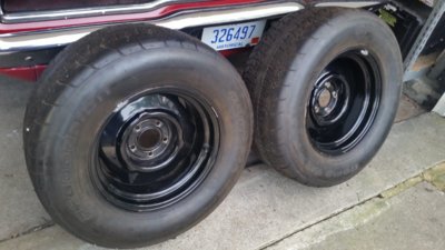

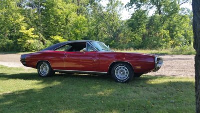

I run 235/60/15 on fronts with 15x7 wheels and 295/50/15 on rears with 15x8 wheels on several diffetent sets of wheels. I didn't want the jacked up in the rear look.
