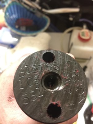

Hello all, got a cam question. So I bought my RR six months ago and I’ve decided to figure out what cam is in this 383, which I’ve experienced some poor performance. She’s been running kinda rich, and just no throttle response. Long story short I’ve torn the engine down to remove the cam because I found a broken valve spring, which certainly is a problem and may explain everything. First, dual valve springs on these heads. #3 exhaust valve spring broke. I’ve found an Erson HI FLOW 2-H grind. Lettering/ Numbers on the cam are B157S8; 108; 581; N. Looking around seems the HI FLOW 2-h grind in a Chrysler big block, advertised duration is 306/306, 235/235 @.050, .472/.472 lift. 108 degree lobe center. Power band: 3000-6000 RPM. So all of that said, too much for a mild street build? My 383 has forged flat tops, 10:1, stock heads, stock 2.08/1.74 valves, edelbrock performer 383 intake, Holley 650, HP manifolds, 2.5” through OEM style mufflers. 4-speed, 3.55’s.

Hey thank you. Good luck with your tear down. I’m just trying to figure this engine build out. It’s always interesting to see what others did when building an engine. I’m just puzzled by the advertised duration, seems a bit much but cams aren’t my strongest point. This engine was rebuilt before I bought the car and seems like a stock rebuild as it still had the stock iron manifold and a Holley 600 on it when I bought it. I added the performer 383 intake and the 650 Holley. I feel like it is simply overcammed given the near stock build, but it’s interesting someone would go to the trouble of installing this cam with 306 degrees advertised duration and dual valve springs without following through with a nice aftermarket dual plane performer RPM and a 750 Holley or similar, and headers, etc. I just want the engine to run as it should and not like the pig it had been. Sure the broken valve spring has to be the root cause for that or a strong factor. Reason I pulled the cam to check is because I found a dual valve spring broken. In my opinion, would take a lot to break one.. any advice here is greatly appreciated folks!

Agreed. I believe the duration or this cam is certainly affecting cylinder pressure at low RPM. Did a compression check and all 8 are consistent around 120 psi. Seems to me it should be at least 135 but I know the duration will lower that pressure. Thoughts? I’m close to just tearing it down completely and rebuilding.
724
Classic Chevy cam that just does not work in a Chrysler engine. To much lift and not enough separation. Hanging both valves open at the same time. I recommend the stock 69 440-6bbl cam. Slightly more lift than stock RR cam but will still have good vacuum at idle and good low end response with your relatively mild build.
