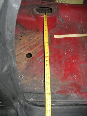

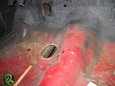

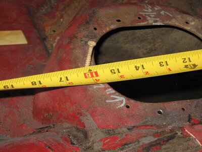

Here is some pic's with measurement's. Hope it help's. The one Measurement is form the fire wall and floor pant where they meet to that screw hole or the back of the hump if you you look. IMG_0109.JPG

You can get the hump from AMD and tell Brewers you dont need it or sell it. No measurments needed Ive done several and they fall into place in the floor pan. Draw a line around it move in about an inch from the line and cut the hole but towards the rear stop at the cross member. Prep and weld. Don't forget the Z-Bar bracket gets welded in the engine bay before paint also.

Hey Russ69Runner. Awesome! Thanks for the photos. I see car does have the factory ‘flat’ spot on the floor tunnel.
