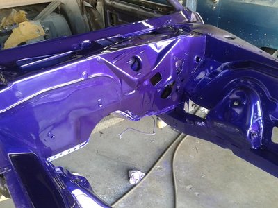

Got everything going now at the new location. Still have to get the lift out of the old shop, however. Haven't been able to work on the Challenger much the past couple of weeks due to the move. I've got the engine compartment finished up for him - he had me shave the firewall and I had to re-do a bunch of bodywork in the engine compartment. I was planning on putting the engine in place prior to the move but ran out of time. Can't wait to start working on it again.

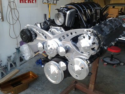

Yeah, I think the owner said it was around $2500 for the setup. Out of my league, for sure
