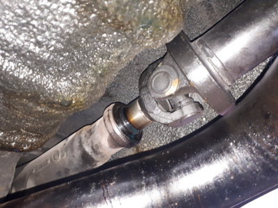

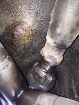

Hi all,
After a acouple of recent road trips, I noticed a slight drip from under the car. Engine bay was clean as, so after a roadside inspection I found the whole trans tunnel covered in oil.
Got it back to my mates shop, looks like its coming from the end of the housing extension. Seems like an easy fix but neither me or my mate have opened one up before.
Just wondering if its a seal (ive found a part on rockauto.com) or is there also a sleeve or bearing it should slip into?
There is a bit of movement in the shaft, which is suggesting its more than just a seal.20180116_084356.jpg 20180116_084356.jpg 20180116_084407.jpg
Any help much appreciated. Photos attached for reference.

It’s your lucky day (imho). Seal replacement time. Drop shaft, replace seal, lube it, make sure trans is full, reassemble.

of all the things that can go wrong this one is pretty easy to fix. check front yoke when remove driveshaft and make sure is smooth so wont mess with the new seal

Since doing the seal swap, ive done a bit of driving, although nothing excessive, and it seems like the seal has gone again. Is this a recurring problem for anyone else?
I recently came back from a month-long holiday, which is the longest the car has gone without being driven since I had it, so im thinking that it might have stiffened up (currently winter down here).
Knew I should have ordered 2 straight away!

How old is the bushing in the tail shaft housing? Might be the cause if its sloppy.

Looks like the pipes are a little too close it my be melting the seal if you drive it for a while maybe or maybe not

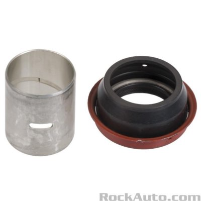

not real sure. I've had the car about a year and a half, and I haven't changed it. I think the 2nd part listing i found comes with a bushing kit
never thought of that! they are tucked up pretty close, and I do take her out on the freeway regularly.
Last drive before the holiday was at the track, so my gut is telling me that if there was any minor issue, that surely would have brought it to my attention. When i got back (from my holiday) i rolled it out of the garage, and notice a couple of spots under the car, coming from roughly under the x pipe, which means it was probably leaking on the way home form the track.
I thought it might have dried out and hardened up, but surely not in a month!

Should not fail that fast. Are built to last years. Back to my original idea, check the yoke shaft for any imperfections that could irritate the seal and abrade it. Did you get the right size? Is the new seal in all the way? Double check the diameter of yoke shaft and make sure not undersized for application. If a little too small will leak. Hope that gives you some ideas and one is correct and solves problem.

the first time we popped it, it had some slight burrs so we linished it and cleaned it up good, and after we swapped the seal I didn't have any complaints. luckily parts are peanuts over there so Ive ordered a couple. We really get jagged for anything automotive down under.

finally changed the seal, turns out the bushing was on the way out too. too much slop was killing the seals one after the other.
got a kit with seal and bushing from rockauto.com for about $10, part number:
NATIONAL 5206.
