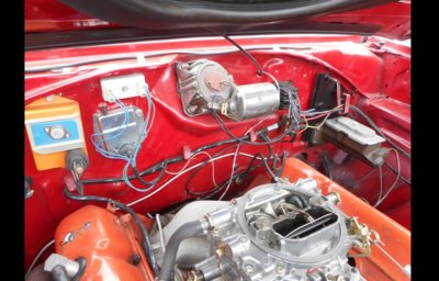

Hi guys, I know this is an old thread but some of the problems I am having have been mentioned in it.
She will start sometimes then cut out. Have tried grounding the lead and get no spark. No obvious loose connections.
I'm thinking it could be the electronic ignition unit mounted on the firewall.
Is there any way to test these?
first pull the ECU and clean the mounting surface...these need a good ground.
Josh
Aug 29, 2016
12
New Zealand
Have tried connecting to the wiper motor with some alligator clips to try and help with grounding. Results have been 50:50 so I am thinking earthing.
First, get yourself a digital multimeter. One of those $25 ish meters from Harbor Fright will work out well. A cheap $5 will work too, but spend a few bucks and get a better one for your garage toolbox and the cheap one goes in your trunk toolbox.
This link has one of the better explanations of how the Mopar ignition works. Read a little and get down to the troubleshooting section.
http://classicwinnebagos.com/forum/index.php?topic=3424.0
People will always suggest changing parts... That's an expensive way to do troubleshooting.... Lots of new ECUs have been bought when the problem was really a bad ground or a lose wire. That said, you should be carrying a spare ballast resistor in your car because they do fail occasionally. It may get you home and having that spare is an easy way to do a quick diagnosis.
