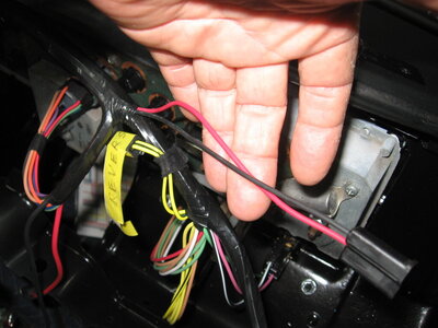

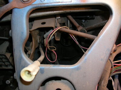

So here is the wire in question. In my hand. I appreciate you guys helping me this is the only one I have not nailed down. This is an L shaped plug. Not unless it has something to do with the tach. So to morrow will get the tach wiring harness out and see. IMG_0101.JPG

I dont think it is tach as it uses the body to ground out. How about a clock instead? It may be too short for that though. Looks like it needs to go right to the left of the instruments. That red looks a lot thicker than just a small voltage carrier.

Thought it might have something to do with the Heat but have that covered. It is a A/C harness with console. Also told them I would have a tach. Said I would have a rear defrost also. That is the only thing I could think it could be. But don't see it on the wiring diagram. The defrost switch should be on that side form what I have seen in pictures. With people throwing thing's out their we just might figure it out. The Tach should have a wire that goes to the coil in the engine bay.

I think you got it, either a/c or the defroster control. Ill see if I can get a confirmation on that.

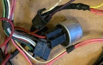

Got it for you, compliments of a guy at moparts... that is for the other flasher...821E2E57-4BF8-4CB9-B34A-9B7E81EAE951.jpeg
7,705
Thanks that sure look's like it. But did not see that on the diagram. It makes sense now. So their are two one for emergency and one for turn. Will also look at the old harness. Left those on it. You know these diagram's are tricky. Maybe was over thinking it. LOL. :thumbsup2:

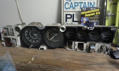

gauge pod.jpg Convert your amp meter to a volt meter. Do you have a rally or non rally dash? I just converted my amp meter to a voltmeter (non rally dash). It looks exactly like the amp meter but will measure the voltage. Take a look at this thread: https://www.forbbodiesonly.com/moparforum/threads/family-tradition.8368/page-54#post-219640 specifically start at POST #1069 (page 54 from member PROPWASH)
I used the Sunpro 2" Voltmeter (P/N CP8205) as he shows. Looks factory and no fires! You will need to either connect the 2 wires from the original amp meter wiring together or do the mad electrical upgrade (I think that is what it is called). Then just follow the directions that came with the voltmeter to hook it up. :)
I've also done a 69 charger rally dash amp meter to volt meter conversion. You use a different volt meter. I would have to check which meter that uses but I did get a new vinyl overlay that says "battery". Looked pretty good when it was done. Here is a pic....
