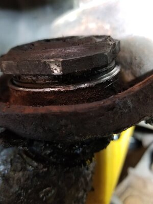

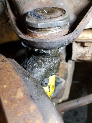

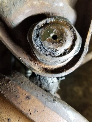

Im so irritated. Started to remove the upper ball joint and its stripped.........what now?

Need more info. What exactly is stripped? The nut spinning on the ball joint or the ball joint in the control arm?
7,704
Yes the top nut. Have had to cut nut's off before that where stripped. Know it is a job. But we have to do what ever it take's. Have cut them off with a torch all so.

This is stripped inside the a arm. So if i cutoff its still inside the arm.

Its crazy i can tighten it up but when i go to loosen it just spins.
7,704
Got you. Yes cant grind that off sorry. Thought it was the nut on the bottom you where talking about. Yes that is a real pain. Use the ball joint puller to push the stud out of the spindle. Then rap it with a hammer while turning the top of the ball joint. Hope that helps. It might screw out if the bolt is not connected to the spindle arm.

Thanks i will give that a try tomorrow
22,143
2,351
If won't come out attatched to the spindle. Separate it from the spindle with a pickle fork and it should come off. I do hope the torsion bars are out or loose before you get hurt.
