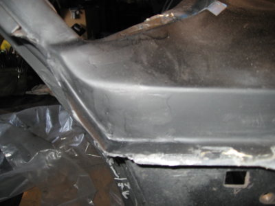

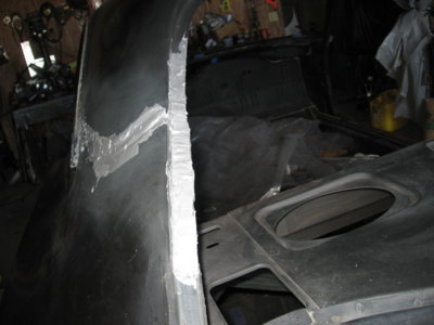

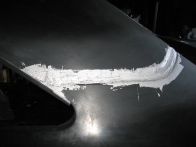

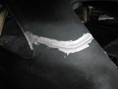

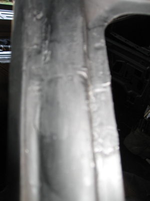

IMG_0101.JPG IMG_0102.JPG IMG_0103 (1).JPG IMG_0104 (1).JPG IMG_0105 (1).JPG Use all metal to finish up the lead joint on A pillar's. Also use it to fill in where quarter meets roof. Keep rust proofing sprayed on it between coat's. One of the last stage's to do before Paint. Also use it to even out the rear window channel. It stick's good and sand's good. Will rub car down one final coat of epoxy then feather fill the car. Have the spray on filler. Not a lot of body work with new metal. Will see how it dose over the year's.
