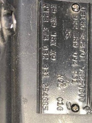

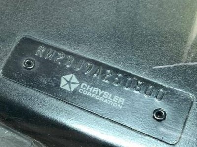

I'm going to be traveling home to Pittsburgh for the Christmas Holiday. I saw this Hemi 69 car advertised for sale and thought I'd go have a look. Not that I'm a buyer, I just like to look especially at the Hemi's. When going over the detailed pictures something seems a little off to me. The Vin on the dash and the Vin on the tag do not match? The Dash Vin clearly shows the "J" code within, but the Vin on the Tag isn't even close. Is this a normal thing for a Hemi car? Hemi Tag.jpg Hemi Vin.jpg

Ah OK, didn't know that. I was focused solely on the bottom row on the Fender tag and didn't even look up top. It's weird that they do it this way. I'm so used to looking at St Louis tags because I like the Verts. Thanks for clearing this up.

It is an N96 car as confirmed by the fender tag, but the hood vents are black, I thought they were supposed to be red. Maybe this is normal for X9 cars with the N96 option? I had read somewhere that early N96 optioned cars the screens were black. Is the build date 3/31? Is that considered "early"? Easy fix if not and you wanted "correct".
It has the "original" 3:23 rear. I would have thought the Hemi's would have come with something more aggressive. Was the rear gear ratio standard 3:23 on all cars and you had to special order if you wanted something different? I don't see the code on the tag for a "sales bank" car like I have on mine.
I can't tell by the add if the Hemi is original to the car or not. I'm guessing a replacement engine takes away from the value somewhat. Normally most cases I see that matching numbers cars are specifically pointed out, here no.

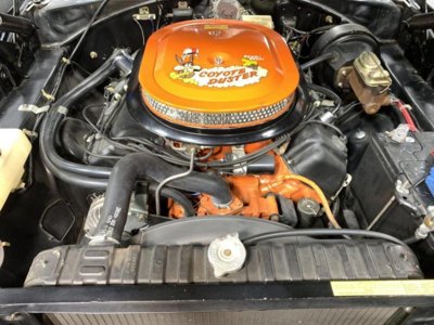

What are the correct carburetors for a 69 Hemi, are they supposed to be Carter? The add doesn't say what they are, but I'm curious.

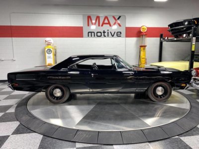

The car presents itself really nice, in fact its beautiful actually. Underneath you can tell the car has been driven, but still very nice, but not concours.
They seem to be asking a lot at $131.2K at least according to Haggerty's guide. By their definition I would say this isn't a 1 car or probably even a 2. But its better than a 3 so somewhere in-between. They obviously have a different opinion than mine.
The add is on Hemmings.

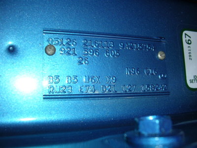

Hemi and 6 bbl cars got the max cool package 26" radiator. That cars tag you posted above has a 26 in the middle of the tag like mine.roadrunner restoration 893.jpg
