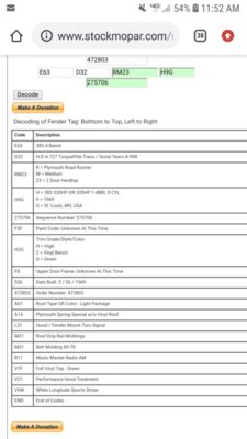

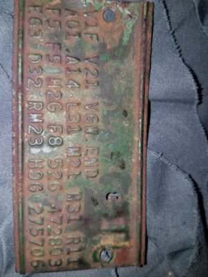

Decoding the fender tag on my 69, A14 no vinyl roof and V1F full vinyl roofScreenshot_20200323-115252_Chrome.jpg

Think there is an error on the decode site you are using. A14 is w vinyl top and A15 is w/o vinyl top

What is spring special w/o vinyl roof ?? Ever heard of that ?
22,143
2,351
In the spring of 69 they introduced a few new colors. W/O vinyl roof means the roof would be painted body color, they did not paint the roof if the car was getting a vinyl roof. Yours being A14 would not have been painted
