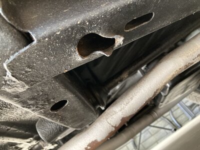

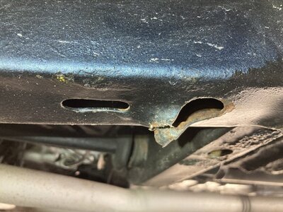

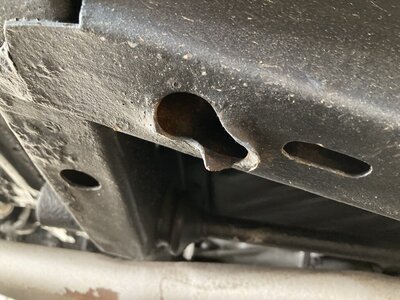

Those drain holes in frame rails must have been used for maybe trailer tie downs...just not too sure!...Any ideas?

That is exactly what has happened. The only way to fix it is to cut it out and weld in new.

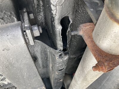

Should I grind it down and then add a little bit of weld to the holes? Also at the time of when Dumb$&@k put the hooks in the frame could it of had an affect on other parts of the frame,like alignment,other weld points?
7,705
I don't think I did any thing else's but open up that rear frame rail. That is a hard place to try and straighten the box out. Would do my best to make it all look like the rest. Put a piece of metal in and weld it up. The front look's like you can hammer that piece back in place and weld it up. The back frame rail is under the trunk pan. Don't know if your taking out the trunk pan. If you are that would be a good time to work on it. Either way it need's to be fixed. It is now a week point the one in the back. Sorry for your luck but had to replace a lot on this car as you may know. Check out my garage Pic's.

I now know which it is too late to go back on. The car was a internet purchase based on pics and info from the dealer. Which without a check done by a 3rd party inspection would have caught all of this and informed me that the purchase is up to me. This is not the end of the world, I will or myself address the issue and or have the deformed frame holes repaired the best way possible. The irony of it all is I am putting it on a uhaul car trailer in a couple of weeks for a move, but no chain hooks just tire tie downs and safety chains not attached to frame rails.

One would think those frame hole deformations would not be a big deal, but I believe that their has to be some weakness created with them being present,I looked over all connections to those rails and everything appears solid. Who ever had it in the past never saw it or blew it off as no big deal. I’m not creating a show car here just a fine part-time daily driver.

I under stand that but like you know metal torn like that is not good. The round hole in the frame is round for a reason. It is still strong. On the other hand a torn piece of metal like in the back is disturbing to me. and would have to fix it for sure. The one in the front would straighten it out and weld it up . The guy or who ever did that had to be a out of his mind. Look's like they really had to pull the heck out of the car to get it out of being stuck or was on the frame. That had to be a hard pull to tear that frame rail in the back. That is what I am thinking. Even if it is just a daily driver better to fix those area's so you won't have any problem's down the road. Just my thought's. Good luck brake out the MIG welder and get some metal the same gauge as the rail and weld it in the back one. You will be a lot better off in the end.

Thanks! I talked with a local restoration guy and he said he’s seen a lot of cars with those holes deformed and attributed it to the old school car truck haulers used chains with hooks to anchor their shipments. He said it can all be fixed right. The one in the back might be able to roll that piece back in place and lay down some nice weld. The one common denominator through the whole search for this car has been...every classic car dealer or seller shows the bottom of the car sprayed with the textured rustproofing. When i’ve called them on it they say it’s just black paint...so whatever! At 50yrs old encapsulating it is the only way. Besides my cargoes to my hot rod daughter when I’m done. Lucky her!!!

Hey you are leaving it to a good person I know. Yes the under coating would have to come off to fix it. So I take it that you don't do welding. My last result would be to take it some where to be done. Too expensive. Would rather do it my self. After all I can mess it up as well as those shop's. For a third of the money. Hey have fun buddy. It is your car and your choice. :beep:
