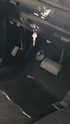

Think every thing is in the car now. So should I put the dimer switch in before the carpet or after it is in. Have seen you should cut the carpet for the console mounting brackets. So any suggestion's would be help full. Tanks.

I put mine in before the carpet.
Did you have the grommet in the carpet for the light switch or did you make an x in the carpet. Have to check mine and see if it came with the grommet. Thanks for the info. Russ.

Install dimmer switch before the carpet , my carpet came with the grommet in the box, I had to install it myself. Be very careful cutting near your wires that plug into the dimmer switch.
