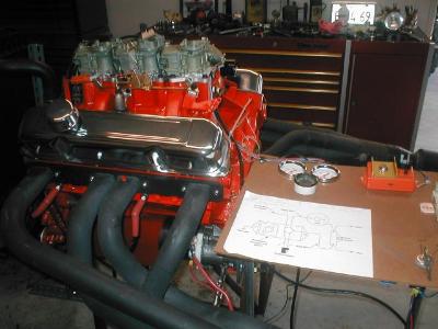

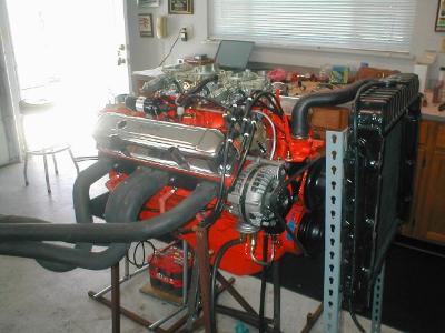

Sorry, no dyno results as I'm low on funds at this point. I did the engine myself and breaking in the cam with single springs only. The valve covers and headers are for the break in only. I have the 2' coated hookers and some stock painted valve covers for it when it goes in the car.
