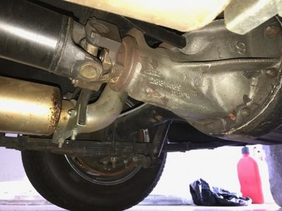

Steve and Bob are on the money. The only other piece of info you'll need to order gears is that this case takes the 1 and 7/8" (1.875") tapered pinion.
