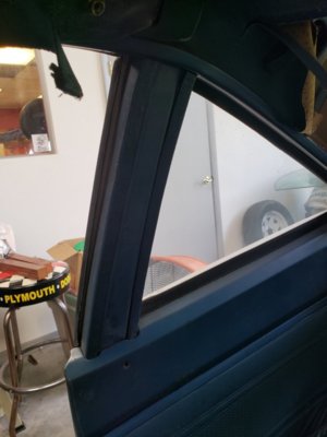

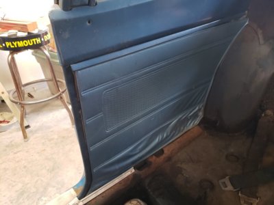

I took these when I disassembled my car last year. Hopefully they show the detail that you are looking for.

Thank you ACME 12. This helps did it run up the hinge pillar also and all the way under the door sill. I still have the pieces for the post I did keep them in a bag by them selves. Know I am asking a lot but need to know how much of this stuff to order. Russ.
