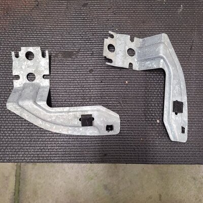

I finally got my car back from the body shop after 2.5 years so have been reassembling and can't figure out where these brackets go. I had them bagged and marked with all the window hardware but can't find a picture of their location. I have the body service manual and it doesn't show in the window section. I'm working on a 71 road runner.

mystery solved. Thanks to a member on another site the brackets bolt on with the door handle and to the top of the door where the sweeps are mounted.
