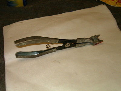

Mass
This is what I used, Not sure where I got it
