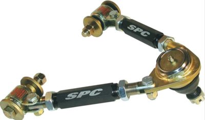

I have a complete QA-1 front suspension system with the K-member ready to go on my 70 V-code Roadrunner. The only part that isn't QA-1 is the UCAs, which are by SPC. Much more adjustable, and that was an area that I have been told my car needed help with. No lack of adjustability with these...Screenshot_20191103-212458_Chrome.jpg
