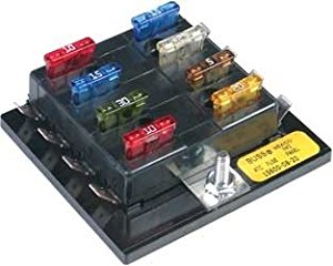

I need to add a 6 circuit auxillary fuse block to my 69 and I'm needing suggestions on how to wire the source power in. I'm thinking I could run an 8 gauge wire from the firewall mounted starter relay but I would like to hear from others that have actually added an auxillary fuse block. I know I could souce the 12v directly from the trunk mounted battery or even on the starter solenoid. The alternator output stud in not an option for me because space is limited. The starter relay would be the most efficient location if there aren't any issues I'm not aware of. Thanks!!!

I currently have an electric fuel pump, nitrous solenoids, gauge lights, and an electric fan that are piggybacked into the factory fuse block. I want to clean this up and take the load off the factory circuits. The circuits will be activated and de-activated with toggle switches so the block itself can be unswitched. I will be mounting the auxillary block close to the factory unit. Is the starter relay post a good place to source the power?

I'm sorry for the late update but........I came off the firewall mounted starter relay with some 6 gauge wiring with a 50 amp maxi fuse in place. I used a bulkhead fitting to run the 6 gauge wiring into the passenger compartment under the dash and just above the factory fuse block. I now have a 8 circuit fuse block mounted that is full and has allowed me to really clean up the factory fuse block. All applicable circuits are non-switched and are on toggle switches. Everything is just as I need it and is working wonderfully.
