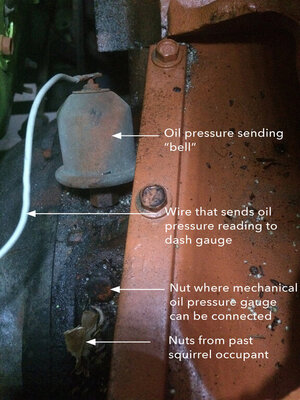

Hey guys - installed new oil filter, fired it up, still no pressure. Gauge doesn't move at all. Next step is get mechanical oil pressure gauge, want to make sure I have the correct place to hook it up, please see attached photo. Appreciate it if you could let me know if I've got the right bolt or nut to remove.
Also wondering if that dirty looking wire off the bell could just be corroded at connection and not sending a signal, dunno I have no clue.
Thank you thank you

Have you tested the oil pressure bell. OHM it and see if it show's any thing. Yes that wire connection look pretty bad. Try clean it all. Maybe bad connection. But figure the bell dose need replace.

Yes ohm push though the wire connector with nothing hooked to it then ground to block. See if you have any resistance at all. But looking at the age of it would say you just need a new one. Just my thought. Yes a new gauge would be the best idea. Or a back up for sure.
