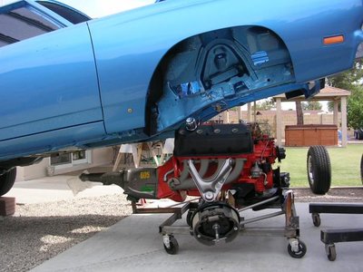

Do you have the assembly dolly to roll it in from underneath? Unless you are putting it in on a dolly from underneath, it's very difficult to install the whole assembly from the top because you will hit the firewall and the radiator support, guaranteed. It's not worth saving a few minutes to avoid putting the trans in separately.

It Is doable. As previously suggested a tilt able lift plate ( I used the one shown. Worked great) and take your time. Cover the top of core support just in case.
