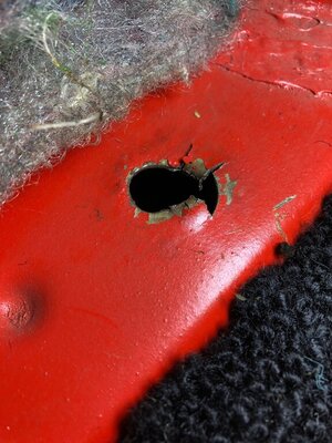

After removing my driver side front bucket seat to remove the instrument cluster I noticed that the outboard seat holes go through a frame underneath each side BUT the inner holes (near the floor hump) do not have any supporting sheet metal, just holes. Was this an original bench seat car? Also please see pic for cracks around the driver side front inner mount hole in floor:

I would say it was a bench seat and was replaced with bucket's. They did not put those support's in when doing it. It is amazing what we find out later after having a car. Only if they could talk to us and tell the story.

Thanks, are the inner support plates for bucket seats welded to the top (inside) floor or welded underneath the floor (bottom) or just placed? Where can I but some? I met a guy last weekend converting a '70 from bench to buckets and he had plates he planned to weld to the inside floor (I was driving by and saw his other Mopar, stopped and visited but did not exchange numbers...)

Sound's like the floor got replaced at one time or another. Think AMD has those plates but not sure for your year of car.

weld them underneath. I don't think there is any special plate. just use some 3/16 steel about 4 x 6 inches. photo size. don't forget to drill the hole. should work fine for you.
