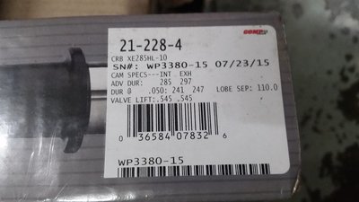

Just about to get my engine back in the RR, and the bloke who's doing all the nitty gritty for me has recommended a 950 Holley 4-banger (a slight upgrade from the 850 Edelbrock that was on there).
Anyone run this before? I'm not loyal to either brand, just interested to know anyone's thoughts. I'll be running my 4-speed 440 with a .545 Comp cam, forged pistons, aluminium heads, so should put decent numbers out.

I had a 383 before, I believe with a 750. I think you'll need the 950 with those heads & cam set-up. I think yours is a hydraulic. My cam is only a .525 lift, mechanical. I was also looking at CompCams web site, usually under specs it tells you what size stall to use as well as gears, what compression pistons & what size carb, but yours doesn't say anything about a carb, I would shoot them an e-mail.
