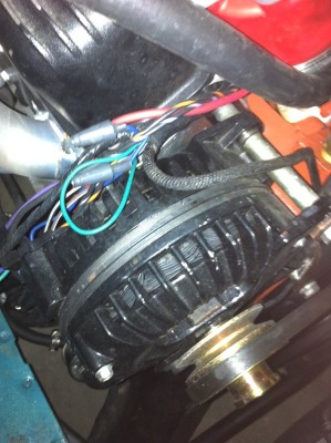

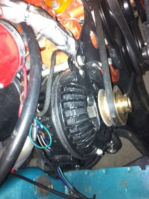

OK guys, so I want get a new alternator, this one doesn't put out enough juice at idle. I think it's bad. I've attached a couple pics if it helps. Not sure what is meant by "single wire" or "exterior regulator" etc. Can you see in the pic what I have, we can't find the receipt for this one so don't know what it is. I'd like to get a replacement, but want to get the right one.

Looks like a single field external regulated but I could tell you for sure with a shot of the back side.
External regulated means there should be a regulator on the firewall or somewhere in engine compartment? Thanks, I'll see if I can get a shot later tonight.
