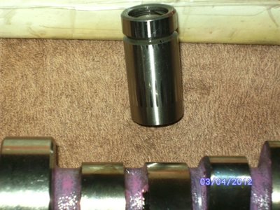

Pulled a cam out of my 383 to install a stock cam. Everything looked great except for this one lifter
outside surface. Tha block is good and slick. I have never
seen this in 40 yrs of messing with engines. What you
think? these marks are all the way around and are evenly
spaced like they were made in it. The lifter turned good
in the block and the lobe surface and cam look great.

The lifter bore in the block is smooth as glass. It looks just like the other bores. It kind of looks like the
lifter was knurled at the factory with high spots. They are the same all the way around and are evenly spaced and
strait up and down. Weird!!
I'll bet it was like that when it went in the motor.
Looks to me like its "chatter" marks from when it was ground. The grinding wheel loaded up or needed redressing. I've seen that type of marks on ground surfaces before.
Interesting... Learned something new...so I'm done for the day... Thanks, Big! :basketcase:

Well it fit the lifter bore fine. I checked it in a couple
of others places and it fits the same. Mic the dia of the lifter
and it measures the same as the good ones. Measured the lobe lift
and it was the same as the other lobes .341. Weird!! I owned the car
for 5 yrs and the one I got it from drove it everywhere. Nothing is hurt just weird looking.
I have never seen that before either. My guess would be same as Johns, but much less articulate. :lol:

i had a simalar situation. my 383 wore the bottom of the lifter off twice in the same bore. Ended up being in the head. I took a straight edge across the top of the valves and they were all sitting at differerent heights. This paticular valve was higher than the rest which was putting too much downward pressure of the pushrod which kept the lifter from rotating on the cam lobe. Destroyed lifter & cam. Good luck!
