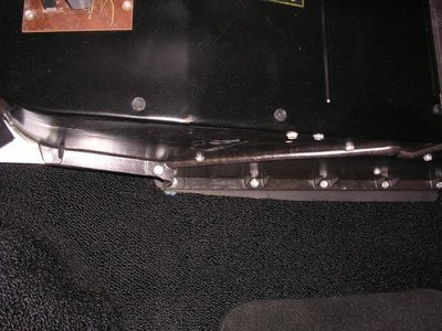

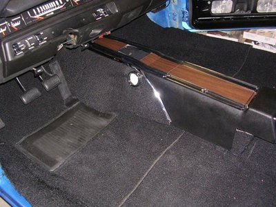

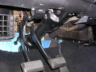

Here are the fire wall pics you wanted.On the passenger side it just goes up behind the heater box just a little bit
