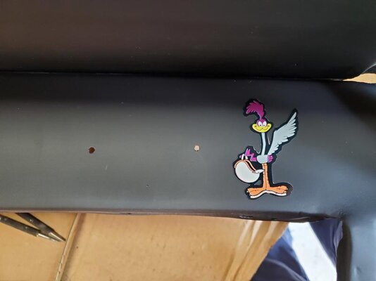

How I did it with out bubbles or having use some kind of liquid.

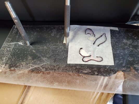

1. Reference the decal to a point . I used the holes in this case.
2. Trace the position of the original.
3. Temporarily remove the non stick paper backing and reposition it to just expose two edges of the adhesive backing piece. It will stick back on just fine.
4. Now you can use a little tape to stick the decal into the exact position of the tracing and use a little tape to secure it from the bottom on the exposed edge(s) of the sticky paper as you feel necessary,
5. Tape the plastic it into position on the new door from just ONE end and stick it smoothly as you lay it in place. Sort of "rolling it".
All you need is one original door in this case. It references from the front hole on either door.
