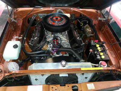

Seems mine has oil in it most of the time slight but still sucking it down the carb. Going to take it off and just use a breather on both sides or oil cap. see what happens.

MP cast covers, just got a new twist in breather so going to try that on a road trip tomorrow. Don't know what's worse oil soaked plugs or dirty oil after a few thousand miles? and yes I have the baffles in place and no my rings aren't bad and no my valve guides are not worn out. Yes carb is a bit rich. I am going to run breathers on both sides see what happens. May have been a bad PVC but it was free when I checked it and worked on vacuum so just experimenting now.
You can hold the hose upside down and drain oil out just a few drops and always seemed to be there wet all the time, seeing that go down the plenum just makes me sick. I know it causing the oil soaking. That and a lot of idling in the garage doesn't help.
So it should get fresh air in one side out the other, see what happens and report back, ran one breather on the drivers side and a oil cap on the other so only one air path in besides the carb lol and didn't notice a difference. my end up going back to the pvc, is the plastic one a good choice?

Went on a cruise today didn't feel any difference. everything drove fine, did notice some smell in the cab for a second at 65 mph but at slower speed didn't seem too bad. Two breathers one on each side.

Took a longer trip this afternoon, seemed ok. more smell than last time, thought I saw some white smoke trailing after a 65-100 romp at decel not sure my rear window is so messed up it was hard to tell. When I get time I will check a few plugs see if anything on the plugs got burned off or looks drier.

Interesting enough pulled a couple of plugs and low and behold the oil was burnt off. wondering if my 493 just doesn't need it. Don't you just love experimenting?

So just to update again. I got those chrome ones, only using the one with the PCV in it. Seems ok and smell seems to be cut down haven't gone on a long trip yet but will soon. Want to clean off the rest of my plugs first.
One thing I liked about this new breather / PCV was that it has the filter inside of it before the PCV so hoping any wet vapor will get absorbed first before getting into the PCV.
Checked out my old PCV and noticed oil on the outside of it where it's rolled like it's failed. Spring and flapper seem ok but who knows?
And yes do have the baffles in place both sides. Push in breather on drivers side and new PCV / twist in breather on the passenger side.
Old PCV shown
Hope it works! if not at least I have a new twist in breather to use as well :)
