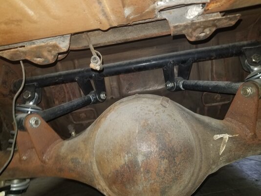

Great response. The leaf springs are all gone and it's been converted to modern suspension and rack and pinion steering. See attached pic.
I would drive it locally, go to car shows, ice cream with my kids etc. Not looking to race the car but if I get on it, I want it to scream and have fun. Different and unique would apply more to the powertrain. I have my color scheme kind of figured out and meband my body are going ro have some fun with that. I was thinking a hellcat drivetrain would be cool and something a little more different than other powertrains but I don't know a lot of other options and I would prefer something new over something that was taken out of a crashed car...which I'm sure can be fine....but new is new.

There are several companies that have “ kits” to put a gen 3 hemi in a roadrunner. You have an 8 3/4 rear end. Don’t know gear ratio from you yet. Fairly tough rear end but there is a reason they put Dana 60’s behind hemis in the day. Remember newer engines require significant work on wiring harnesses and sensors as well as transmission integration

Do a Dana instead of the more common 8 3/4 while you are at it to cover all the extra power bases down the road you are planning.

Coil over and 4 link are fine. Sorry rapid. Will disagree slightly with you there. Just put that type setup under my runner. What did they do for the front end? Do you want a stick or an automatic? Basic questions can get you going in the right direction.

I guess my question to you would be…..are you looking for the feeling of driving a modern car, but having the looks of a classic? The modern suspension upgrades are fine if you plan on going around corners in a spirited manner, but it loses the feel of driving a classic. So, to that end, if you like the feeling of driving a modern car, go with a modern drivetrain. Find a Hellcat motor, use the guidance of those who have put them into a B body, and motor on happily ever after.
Myself? I’m in the hobby because I like the feel of driving a classic car the way they came, I like the feel of the road, the whistling of the wind through the windlace, the sheer feel of a mechanized machine that is barely tameable by todays standards. That’s just me, so I have a 70 6bbl 4 speed Roadrunner with manual steering and manual drum brakes, and I enjoy every second behind the wheel. Look inside yourself, and decide what you like the best, and enjoy getting to your destination, both with the car and in the car. If you follow your heart, you will always be proud to open the hood and show off what YOU love about your car.
I don't think we disagree.
It's just an opinion.
I told him what I would do if it was me, based on the limited information.
Who put that set up in the car?
Is it well done?
Is it welded in? I can't tell or inspect the soundness of the system.
How much HP is he going to have. (Sounds like a lot)
A coil over 4 link may be fine for some, but I'm wondering.
What's the advantage of leaving the current set up in the car other than money?
Many people do question the ability of an 8 3/4 to handle more power. (I'm not one of them, necessarily)
Some people put the Ford 9 inch in reasons important only to them..
Cost, availability?
Didn't Chrysler specify a Dana with a 440 or Hemi 4 speed?
In fact, you mentioned that Dana option in post 5.
I think he indicates money will be spent on this project.
A complete, new rear just like Chrysler designed it can be bought without taking something out of a "crashed car".
And we know it will handle what he puts in the car.
That's simply the way I would go.
I'm conservative.
He says he doesn't "feel" like he is going to sell the car.
But what if he does?
Will it be a Foose or a FUBAR to the next person?
