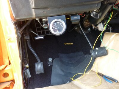

The FUEL gauge saga continues.............
I decided to install an after market gauge. I still plan on getting the stock in dash gauge working as well. Solved the question of whether one can run two gauges off of the one sending unit. YES, you can using a double pole toggle switch. One can then choose which gauge to view by just the flip of a switch. My after market gauge works perfect but the in dash stock gauge is still NOT responding.
The ignition swith checks out. The sending wire is good up to the toggle switch. The stock type voltage limiter I replaced with the solid state limiter is also working. I have NOT tested the solid state limiter in the car. The stock gauge works- when I removed the sending wire at the sender and ground it, the gauge moved up to the full mark. I suspect that the stock gauge is NOT getting juice. The gauge responded to the FULL mark when grounding the wire at the sender so that means the sender wire is GOOD. Have to see if the limiter checks out. I like to keep the solid state limiter so hoping it is working...........
Pictures attached................
