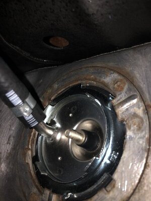

This particular car has been pin balling around the classic car market most of 2020. I know of at least 4 previous owners in 2020 that are dealers. Hope that is not a bad thing! The tank on this bird looks brand new,no finish or spray so i'm guessing fairly new. I'm going to look at it a little closer today and see if there is any movement in the lock ring(carefully). Might also just be some tightening of the hose clamp on the fuel line.
I will update. But it sounds like i should just order a new sending unit w/gasket just in case.
Opinions welcome!!

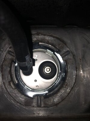

This is a photo of my 70 , I put it up on the rack to see how much more clearance you would hav and it is the best way to change the sending unit.D827A2A8-9E69-42E8-A974-67BA484AD0D8.jpegA9F5E700-65C0-4F39-B86E-B4A3D23B63C1.jpeg

The thickness and strength of the aftermarket trim/lock rings are both thinner and not as strong. You may have to bend the tabs up slightly to increase the pressure applied to the gasket when in the locked position. Also looks like to me you pick up is rusty especially where the wire plugs into it and that there is also some sort of goop all over it as though someone was trying to seal it previously. You may need a new pick up too.

According to info researched on this vehicle,it was restored 15+yes ago.
I think for someone this was a project involving some complete new parts. However the tank appears new but that sending unit area has aged a bit or maybe they put the old one back in.
Not wild about the bare ground wire wrapped around the base of the fuel line tube with a small hose clamp,seems very backyard mechanic to me,also the wire for the sending unit is questionable. Hopefully no fires!

Fuel sending units are not very expensive. Why. It just put a new one in? Yours looks very suspect

Super accurate statement. I suggested it as it looks as though it may be coming from where the wire plugs into the sender. Kinda rusted and maybe rotten? But as 69hemibeep says if it’s a working (accurately) gauge maybe keep it and restore/fix the leaks...

I like the look of 68Man's 70 sending unitnew and clean. Do you think it can be done with an empty tank and release the hanger bolts and do a drop down or should i have it done with supplied sending unit and ground strap??
Also noticed that the lead wire to the sending unit looks a little raunchy and i'm seeing the wire exposed near the plug end...Not good! Is that lead connection easily found to replace and how does or where does the ground strap attach??

The ground strap is installed on mine now so I will take a picture and post it some time today. Also the new sending unit that I purchased from Parts Mix appears to be reading correct.
