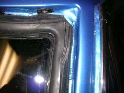

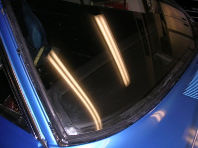

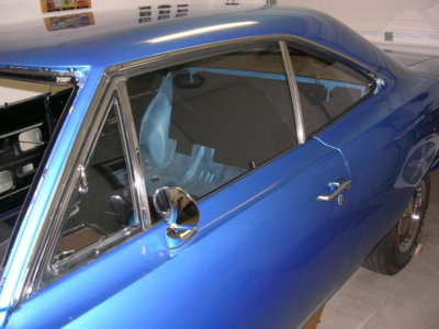

I have a couple of pics when settin the glass you can see some of the clips in if that will helproadrunner restoration 927.jpg roadrunner restoration 929.jpg roadrunner restoration 925.jpg

Yep figured you had some pic's. Thank you. It make's me cry to drill holes in the new sheet metal. Wanted them drilled before applying paint. I could just see the drill bit sliding or jumping up and skinning the new paint. Take care buddy.
