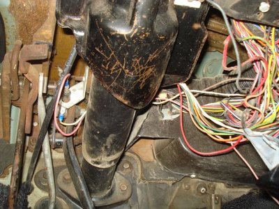

I must agree with your assessment. I believe the best investment or insurance anyone can buy is a new under dash harness. Mopar's are noted for burning the main wire to the amp gauge causing it to short out. I am not saying ALL Mopar's have this problem BUT, many have. Also, possibly the voltage limiter has gone haywire. The gauges in my 69' are original and work well even after sitting since 1979.

Yes the cluster bolts to the dash acts as a ground. Are you sure your limiter is good and the circuit board and pins on it are solid? also check the plug to the cluster those pins come lose and push out if your not careful taking it on and off.

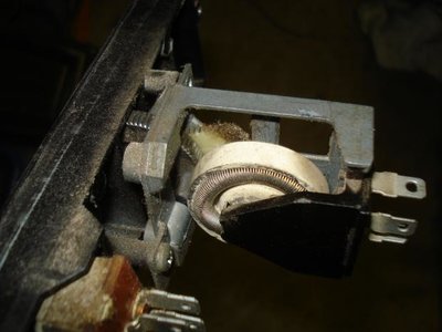

So far everything is working that I have hooked up. Won't use any gauges besides speedo and fuel gauge. Still haven't tested those out yet. I do know my dimmer is broke bc it is either on or off.
A12
Jul 16, 2009
472

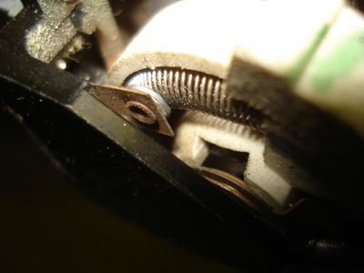

Some times you can fix the dimmer switch by checking that the contact is touching at all settings, and that it is clean and also checking the condition of the coil that it contacts.

Just use a multi-meter to check continuity for full rotation of the dimmer wheel
A12
Jul 16, 2009
472
The dimmer may just need a good cleaning. That's all I had to do to mine.
Good point! I think the worst that I've had to do was fix one of the terminal connections but they can be repaired.
