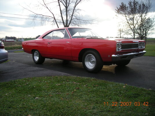

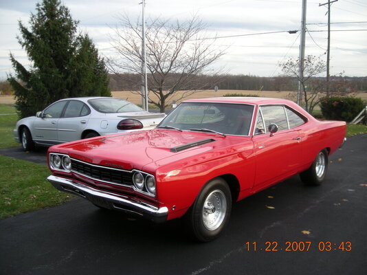

Not a good day. Sorry for your luck. Beautiful car. Love the color. Is it an automatic transmission? Hope your back on the road soon.

I noticed that you have tow tabs on front of your bird , couldn't flat tow it saves towing bill ?:beep:
