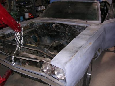

LL1 Surf Turquoise. Bet it was sharp when it was new.
I talked her into going back to that color. Her hubby was a painter so it saw gold and olive of all colors, I also told her I wasn't going to work on it with a black engine bay so it going in for paint soon :D
IMHO the Surf Turquoise would be the color to go back to! Awful nice of you to help this lady with her ride ,but could you tell me WHY you wouldn't work on the car with a black engine bay? Any connection to Generic Motors practices? Just curious and as you may know, own a R4 bird with a black engine bay....

The engine is pulled and she wanted the car the way she got it (Surf Turquoise) There is no reason to leave it flat black when the black is in bad shape so it needs painted. She is overly excited about getting it running I have to settle her down and do things right. If your engine bay is black that's fine and I wouldn't pull the motor for that reason but this one is apart and begging for paint. I am a bit of a purist in that respect but that's just me, and my name is going on it. Thank you for your input on the 87 octane we have pretty crappy gas here.
