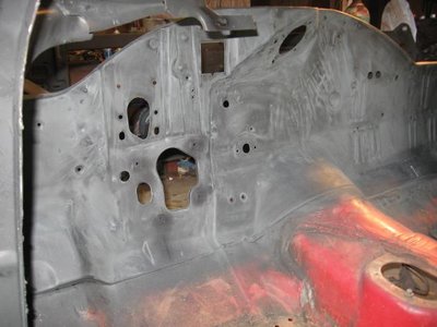

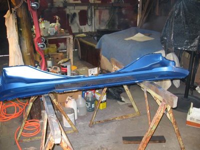

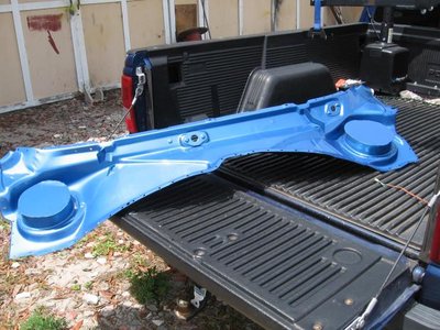

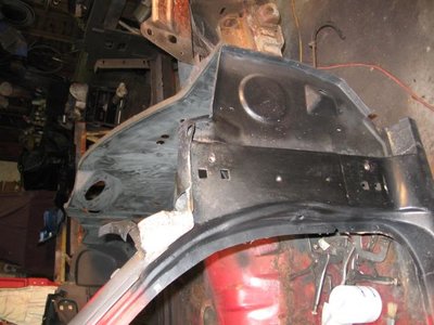

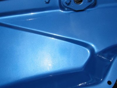

IMG_0101 (2).jpgIMG_0102 (2).jpgIMG_0103.jpgIMG_0104 (1).jpgIMG_0105 (1).jpg Well here are some pic's of my upper and lower cowl section's before welding the on the car. Just cant reach these areas after you put them on it makes life a lot easy. Put some royal blue metal flake over the b 5 blue used color blender to spray it out 1.8 nozzle on paint gun top load not can sprayer. Also the passenger side door hinge pillar and lower body cowl. Painted the fire wall with epoxy after cleaning that ugly red off of it and rust proofed it. It is slow but this stuff dose take time to do it rite. :cartman: Gee think I could do a better job than that. LOL.

OH the shine stuff on the lower A pillar is tinning to apply the solider between the lower cowl and lower A pillar like the factory. It is a pain to get the tinning to work. Using a hand held electric heat gun work's good. The torch was to hot and put heat every where. It wanted to burn up the rust prof off or paint that I had applied. Well the life of a body man can't wait till it is done. Russ. :popcorn: Hey their is a Roadrunner cartoon on that stupid coyote!!!
