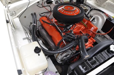

I used the Totally Auto stuff...it's been about 3 yrs & holding up nicely...no primer. Took about 3 cans.
Me to, a little more out of pocket but I liked it :thumbsup:
